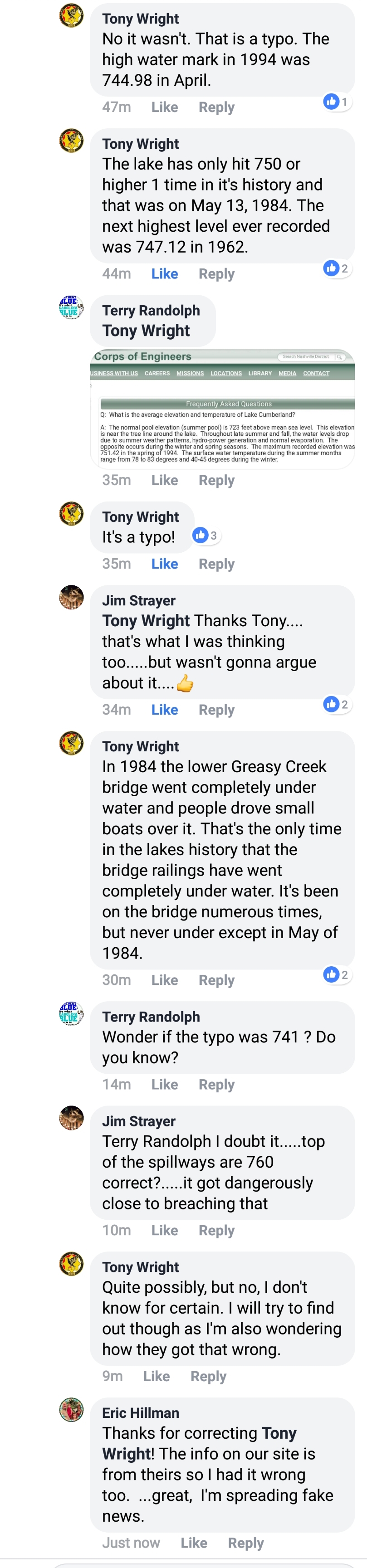

The lowest recorded water levels—
673.01 January 1, 1954 – Lowest recorded level since lake was filled
677.80 February 9, 1977 – This was a dam repair period
The highest recorded water levels—

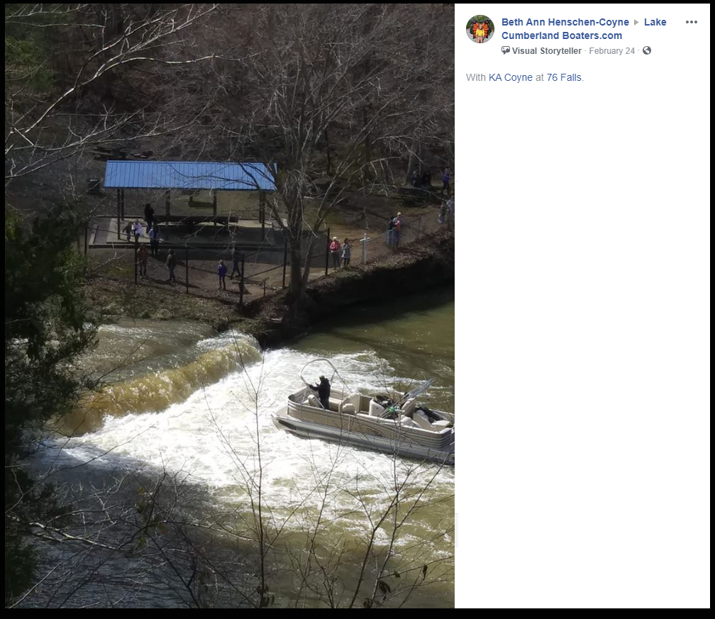

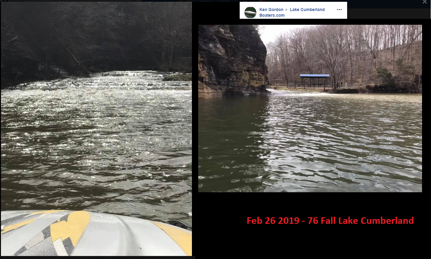

756.52 - 5 am Tuesday Feb. 26th 2019
76 Falls Feb 26th 2019 b.png (1.21 MiB) Viewed 21523 times
76 Falls Feb 24th 2019.png (819.2 KiB) Viewed 21523 times

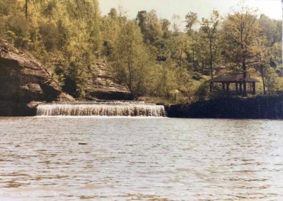

751.70 May 13, 1984 – Recorded at 2 a.m.
76 Fall 1984.jpg (74.56 KiB) Viewed 22009 times
747.12 April 15, 1962 – Recorded at 4 p.m.
https://www.lrn.usace.army.mil/Media/Ne ... to-recede/
Lake Cumberland hit a record lake level Tuesday, Feb. 26, and Wolf Creek Dam has also reached record releases today. Water levels are beginning to recede.
Lake Cumberland reached elevation 756.52 feet 5 a.m., Tuesday, which is the new pool of record. The previous pool of record of 751.69 feet stood since May 1984. The releases this morning at 8 a.m. were 59,880 cubic feet per second, which is also a record for discharge from Wolf Creek Dam.

Old 1984 record broken between 8 and 9pm on Feb 23 2019
New Max Elevation updated in 2019 still rising as of 2-25-2019 - 756.07+
