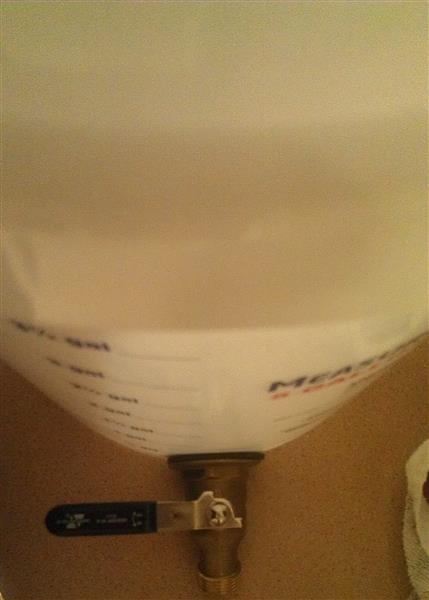

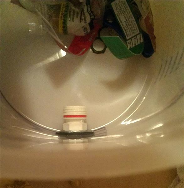

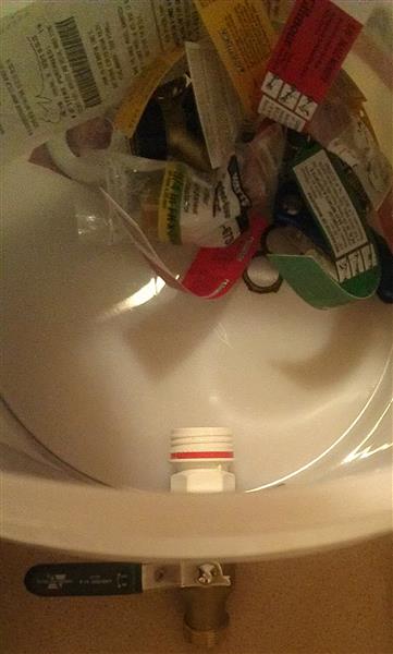

1. Drill 1” hole in bucket at lowest level possible but where sillcock is not below buttom rim of bucket.
2. Take 3/3 x ¾ mip apart and keep the threaded half. On threaded half slide on 1” metal washer (you may have to grind it down on the bottom side to where it fits)
3. I could not find a rubber washer that would fit the 1” needs so the ones I purchased I cut a 1” circle out of the middle and then placed one next to the metal washer on the mip where it would make contact with the bucket..
4. Slide threads of mip through inside of bucket with the rubber washer against the inside of the bucket.
5. Place other rubber washer over threads sticking out of bucket
6. Put ¼ turn sillcock onto threads and tighten
7. Attach 2 way onto sillcock
8. Place ¾ x ¾ hose fitting (connects a male to male) to one of the 2 way threads.
(Bucket is done) You can get bulkhead connectors like this http://bucketape.com/bucketapeimages/bulkhead1.jpg from Bucketape.com but I like my setup.

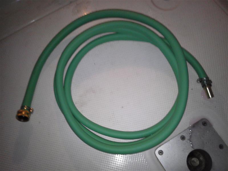

Boat hose – cut a length of hose with male end to size to go from muffs on outdrive up to back of boat then place 1 Female metal hose end on other end
AC hose – cut a length of hose long enough to go from cockpit floor down into engine compartment and connect to disconnected hose at petcock then place the metal clamp hose mender in one end and a female hose end on the other.
(if you have garden hose left from what you were cutting from you can then place a mender male end on it)

Here are some pics....
