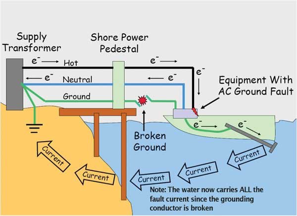

Illustration of how electricity gets in the waterFor stray AC to get into the water, there must be an electrical fault and a fault in the safety ground. (Courtesy David Rifkin)
How does that electricity get into the water in the first place? In a properly functioning electrical system, all of the 120-volt AC current that goes into the boat through the shore power cord returns to its source — the transformer ashore or on the dock where it originated. For any of that current to wind up in the water, three things have to occur.
Electrical fault. Somewhere current must be escaping from the system and trying to find another path back to its source ashore.
AC safety ground fault. The AC grounding system must be compromised so that stray current cannot easily return to ground through the ground safety wire. Any stray electricity then has only one path back to its source — through the water.
No ground fault protection. Any current returning to its source through the water will create a slight but detectable difference between the amount of current traveling to the boat and returning from it through the shore power cables. Ground Fault Protection (GFP) devices, like Ground Fault Circuit Interrupters (GFCIs) required in bathrooms ashore, are designed to detect differences measured in milliamps and to shut down the electricity within a fraction of a second. If the circuit does not have one, then electricity will continue to flow into the water.
If all of these conditions exist, then some or all of the boat's underwater metals, such as the propeller, stern drive, or through-hull fittings, will be energized, and electricity will radiate out from these fittings into the water. If the boat is in saltwater, the current will dissipate without doing damage unless a diver grabs hold of the energized metal. In fresh water, 120-volt AC will set up a dangerous voltage gradient that will pass through any swimmer who bridges it.

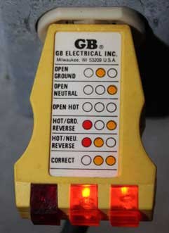

Figuring out if your boat has a problem requires two specialized tools — a basic circuit tester and a clamp meter — that together cost about $150. If you keep your boat in a freshwater marina, the marina operator should have both and be using them to check the boats on their docks.
To determine if your boat is leaking AC, start by checking the dock wiring. Plug the circuit tester into the shore power cord receptacle you use on your pedestal. The lights on the circuit tester will tell you whether or not the shore power system is functioning as it should. There are situations where those lights can mislead you, but as a first approximation, assume all is well if the circuit tester says it is. If you find any problems, alert your marina manager or call an electrician certified to ABYC (American Boat and Yacht Council) standards.

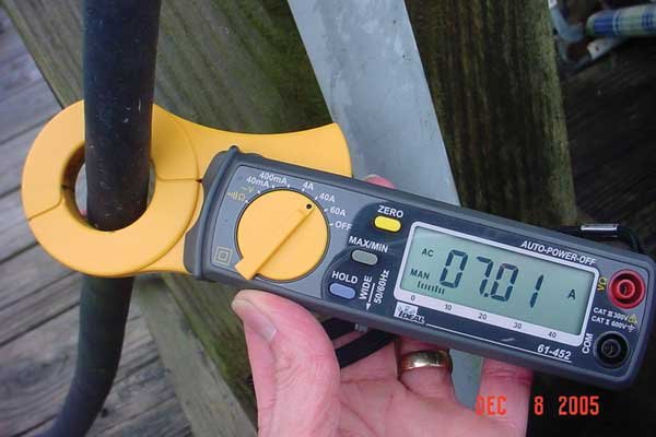

Once you have established that the dock's electrical system is sound, take the clamp meter and put it around your shore power cord. Most electricians use a clamp meter to measure the current flowing through the neutral, hot, and ground wires separately, but we are interested in whether or not all of the current entering the boat is leaving it. If that is the case, the current passing through all of the wires will sum to zero, and that's what the meter will show when the clamp is put around the entire shore power cord. If the clamp meter shows anything but zero, either some of the current going to your boat is entering the water, or current leaking from the dock or another boat is returning to its source ashore through the metal fittings on your boat. To determine which, turn off the power at the pedestal. If the clamp meter continues to show the same reading it did when the pedestal was on, the current is coming from somewhere else. If any or all of the current goes away, then your boat is leaking some current into the water.
Photo of a clamp meterThis clamp meter shows a 7-amp difference between the current going into the boat and coming out. (Courtesy David Rifkin)
Unfortunately, that's not quite all there is to it. Many of the most dangerous AC loads on a boat, like air conditioning and refrigeration, are cycling loads. A fault in one of these will only show up if that equipment is running when you clamp the cord. To be sure your boat is not leaking AC into the water, you must run all your AC loads while clamping the cord and look for any reading but zero. If you find a problem, unplug your boat and don't plug it in again until you get an electrician trained to ABYC standards to figure out what is wrong and fix it.
